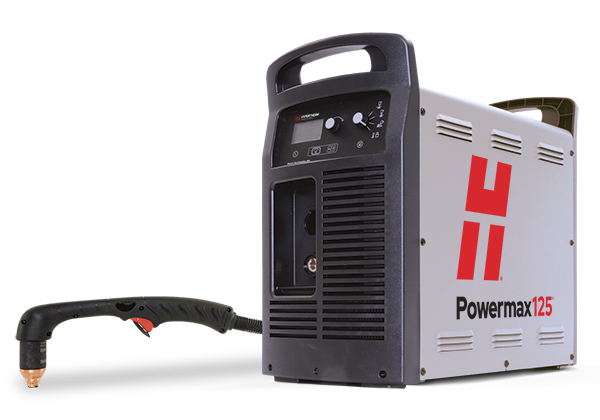

Powermax125 plasma cutter

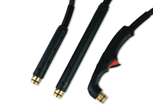

Delivering maximum power and performance for air plasma, the Powermax125® plasma system cuts thick metals fast. Able to make short work of the toughest cutting and gouging jobs, the system offers a 100% duty cycle, a 25 mm (1″) mechanized pierce capability, and fast gouging metal removal. It also gives you the latest technological innovations, such as Smart Sense™ technology to automatically adjust the gas pressure. Eleven Duramax® Hyamp™ torch styles provide versatility for hand cutting, portable automation, X-Y table cutting, extended reach cutting, and robotic cutting and gouging.

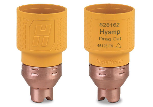

- Drag cut at full output with a patented shield that reduces dross buildup for smoother cutting

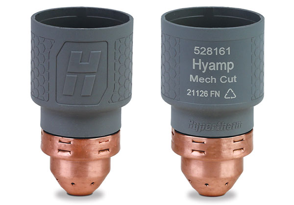

Starter kit consumable options
(View related consumables section for all consumable kit options )
Handheld | Mechanized | Mechanized with ohmic retaining cap | |
Kit | 428099 | 428100 | 428101 |
Duramax Hyamp torch options
Hand torches | Machine torches | Robotic torches | Long torches | ||||||||
Cable length | 85° | 15° | 180° | Mini 180° | 45° | 90° | 180° | 0,6 m (2′),45° | 0,6 m (2′),90° | 1,2 m (4′),45° | 1,2 m (4′),90° |
4,5 m (15′) | 059519 | 059514 | |||||||||
7,6 m (25′) | 059492 | 059495 | 059520 | 059515 | 059564 | 059565 | 059566 | 059562 | 059563 | 059567 | 059568 |
10,7 m (35′) | 059521 | 059516 | |||||||||
15,2 m (50′) | 059493 | 059496 | 059522 | 059517 | 059579 | 059580 | 059581 | 059582 | |||
22,8 m (75′) | 059494 | 059497 | 059523 |
