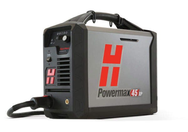

Powermax45 XP plasma cutter
The Powermax45® XP plasma cutter provides a recommended cut capacity – up to 16 mm (5/8″) – as well as fast cut speeds, and automatic gas adjustment for quick, simple setup and operation. Duramax® Lock torches support handheld and mechanized cutting of a wider range of metal thicknesses, along with precision gouging such as spot weld removal, and marking capabilities.
