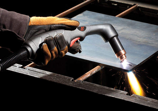

Duramax retrofit torches for Powermax600/800/900 and MAX42/43 systems
Duramax™ retrofit torches can give older Powermax system new life with enhanced performance and productivity. Available for Powermax600/800/900 and MAX42/43 systems, –retrofit torches use the torch connection designed for your system, so installation is simple; both handheld and mechanized styles are available with or without quick disconnect.
- Handheld and machine styles available
- Proprietary, fiber-reinforced torch handle is 5 times more impact resistant and 20% more heat resistant than T-style torches
- SpringStart™ electrode technology eliminates moving parts in the torch for more reliable arc-starting

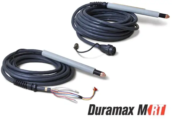

Duramax MRT mechanized torches with and without quick disconnect
Torch assemblies
Consumables, operator manual and consumables sticker for your system included.
| Part number | Description - Systems |
| 228920 | MRT machine torch assembly, 7.6 m (25' ) leads - Powermax600, Powermax800, Powermax900, MAX42, MAX43 |
| 228921 | MRT machine torch assembly, 15.2 m (50') leads - Powermax600, Powermax800, Powermax900, MAX42, MAX43 |
| 228922 | MRT machine torch assembly, 7.6 m (25' ) leads* - Powermax600 CE |
*Without quick disconnect

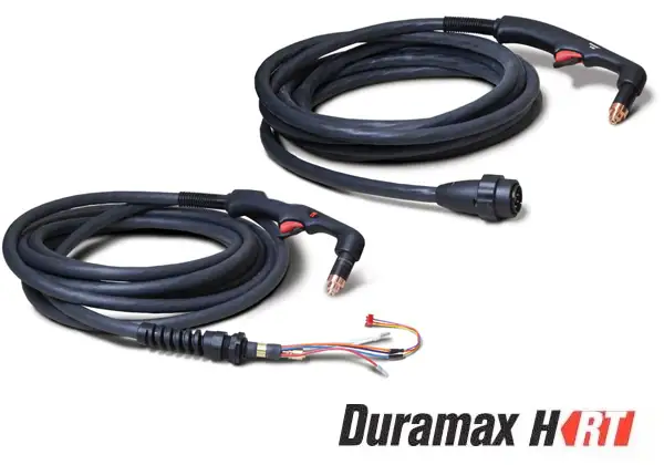

Duramax HRT hand torches with and without quick disconnect
Torch assemblies
| 228916 | HRT hand torch assembly, 7.6 m (25') leads - Powermax600, Powermax800, Powermax900, MAX42, MAX43 |
| 228917 | HRT hand torch assembly, 15.2 m (50') leads - Powermax600, Powermax800, Powermax900, MAX42, MAX43 |
| 228918 | HRT hand torch assembly, 7.6 m (25') leads* - Powermax600 CE |
* Without quick disconnect
