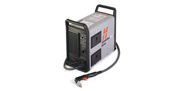

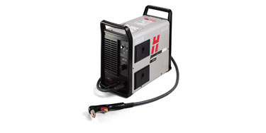

Duramax retrofit torches for Powermax1000/1250/1650
Duramax™ retrofit torches can give your Powermax1000, 1250 or 1650 system new life with enhanced performance and reliability. Easy Torch Removal (ETR) connections come standard, making installation, literally, a snap.

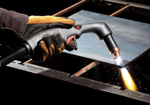

Benefits
More consumable life
Conical Flow™ nozzle and Spring electrode give you up to 30% reduction in consumable costs over T-style torches*
* When compared with standard T60/T80/T100 torches and/or consumables.
More reliable arc-starting
SpringStart™ electrode technology eliminates moving parts in the torch for more reliable arc-starting.
More durable
Proprietary, fiber-reinforced torch handle is 5 times more impact resistant and 20% more heat resistant than T-style torches
For even greater savings, CopperPlus™ long life electrodes provide dramatically longer service life than standard consumables when cutting metal 1/2" and under.

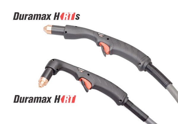

Duramax HRT and HRTs hand torches
Torch Assemblies
Consumables, operator manual and consumables sticker for your system included.
| Part number | Description |
| 228788 | HRT Hand Torch Assembly, 25' (7.6 m) Leads |
| 228789 | HRT Hand Torch Assembly, 50' (15.2 m) Leads |
| 228807 | HRTs Hand Torch Assembly, 25' (7.6 m) Leads |
