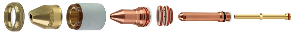

Shield Shield cap Nozzle Swirl ring Electrode Water tube
Torch consumable parts
 200 amp - Air consumables - Mild steel / Stainless steel / Aluminum
Amperage Shield Shield cap Nozzle Swirl ring Electrode Water tube
50 A 220532 220936 220890 220529 220528 220521
    220935 without tab
130 A 220536 220936 220892 220488 220487 220521
    220935 without tab
200 A 420045 220936 420044 220488 220937 220521
    220935 without tab
O2 – Mild steel
Shield Shield cap Nozzle Swirl ring Electrode Water tubeTorch consumable parts
200 amp - O2 consumables - Mild steel
50 A 220532 220936 220891 220529 220528 220521
    220935 without tab
130 A 220491 220936 220893 220488 220487 220521
    220935 without tab
200 A 220832 220936 220831 220834 220937 220521
    220935 without tab
N2 – Stainless steel / Aluminum
200 amp - N2 consumables - Stainless steel / Aluminum
130 A 220536 220936 220892 220529 020415 220521
    220935 without tab
200 A 420045 220936 420044 220529 020415 220521
    220935 without tab
MAXPRO200 hand torch consumables
Air – Mild steel / Stainless steel / Aluminum
Shield Shield cap Nozzle Swirl ring Electrode Water tube Torch consumable parts
50 A 420063 220935 220890 220529 220528 220521
130 A 420061 220935 220892 220488 220487 220521
200 A 420058 220935 420044 220488 220937 220521
200 A gouging 420067 220935 420066 220488 220937 220521
O2 – Mild steel
50 A 420063 220935 220891 220529 220528 220521
130 A 420062 220935 220893 220488 220487 220521
200 A 420059 220935 220831 220834 220937 220521
MAXPRO200 extreme bevel consumables
Air – Mild steel
MAXPRO200 extreme bevel consumable parts
130 A 420735 220936 420829 220488 420824 420823
    220935 without tab
200 A 420737 220936 420734 220488 420732 420823
    220935 without tab
O2 – Mild steel
130 A 420735 220936 420828 220529 420824 420823
    220935 without tab
200 A 420737 220936 420733 220488 420732 420823
    220935 without tab
