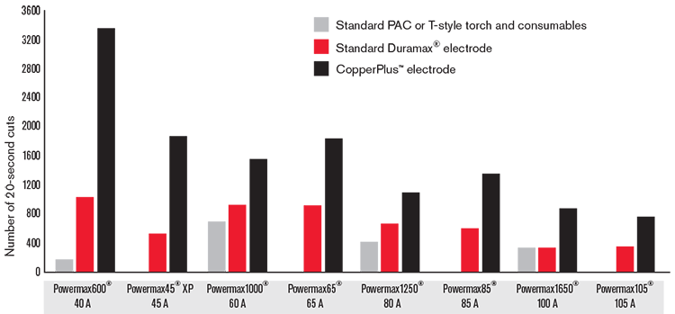

Designed for Duramax®, Duramax Lock and Duramax retrofit torches, CopperPlus™ electrodes deliver at least two times the life over standard Duramax electrodes when cutting metal 12.5 mm (1/2") and under. Double the life means you can cut more parts with fewer changeovers – increasing uptime and reducing your operating costs.
Consumable information
Specifications
Consumable life data
Consumable life data of CopperPlus
Note: Lab testing shows that CopperPlus will deliver at least 2 times longer consumable life in most cases; consumable life may vary depending on the system, amperage and process.
