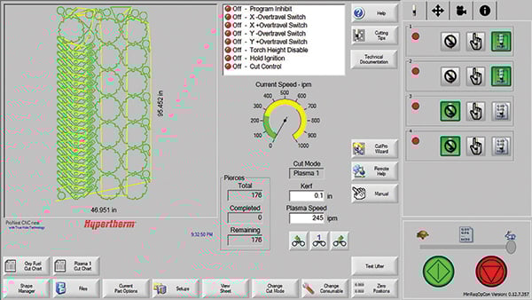

  • With Patented CutPro® Wizard, even new operators can be cutting production parts in less than five minutes
  • On-screen Software Operator’s Console (Soft OpCon) allows easy setup and operation of cutting station and manual motion
  • Integrated communications with plasma and torch height control systems deliver automated and expert control using installed factory or custom cut charts
  • Custom cut charts can be created and controlled in the part program or made available to the CutPro Wizard

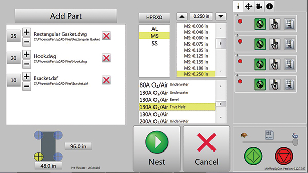

ProNest® CNC nesting
  • Easy-to-use touch screen interface, machine operators can create nested part programs and obtain optimal cut quality without extensive training.
  • Directly imports DXF, DWG, CAM, DGN, and CNC simple shapes.
  • Embedded SureCut™ technology maximizes performance through embedded expertise. Patented True Hole® technology with process verification ensures all operator variables are properly set.
  • Pattern Array Nesting for a single part with process optimization included.
  • True Shape Nesting module for multiple parts (included when using EDGE Connect and ProNest on the same internal network; available as a paid option for users without Pronest or an internal network connection).

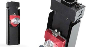

  • Optional Sensor™ plasma torch height control mechanics (Sensor THC)

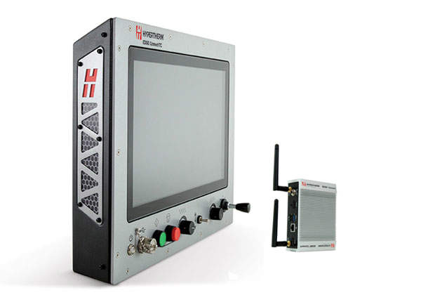

The smallest of the CNC configurations, the EDGE Connect offers the greatest flexibility for machine integration. Cutting machine OEMs provide the touch screen and any operator switches.
EDGE Connect TC
EDGE Connect TC
Integrates the EDGE Connect CNC into an industrial enclosure with a 495 mm (19.5") touchscreen. A hardware operator’s console with switches for start, stop, program and manual speed control, raise/lower torch and joystick is included for easy operation.
