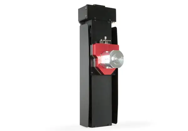

Sensor torch height control
Specifically designed to integrate with Hypertherm’s CNC solutions, the Sensor® torch height control (THC) is a full-featured torch height control system that can significantly increase the productivity and profitability of your shape cutting operation.
The easy-to-use, easy-to-install unit offers integrated CNC software features and closed loop servo control, as well as the latest advances in system integration and hardware reliability.

Dimensions 127 mm (5.0") X 152 mm (5.9") X 526.5 mm (20.73")
Lifter stroke length 241 mm (9.4")
Weight 11.27 kg (24.85 lb) without breakaway and torch block
Motor OEM Supplied - 60 mm (2.36 in.) flange with a 70 mm (2.756 in.) bolt circle diameter
Maximum lift capacity rating 11.4 kg (25 lbs)
Maximum speed rating 15,200 mm/min (600 in/min)
Communication protocol Discrete wiring to motor and I/O
EtherCat to the HPR plasma system
Humidity 95% RH
Operating environment -10° C to + 40° C ambient (14° F to 104° F ambient)
Optional torch mount / breakaway assembly 11.4 kg (25 lbs) magnetic (recommended)
4.5 kg (10 lbs) magnetic
Torch mounting block options include 51 mm (2"), 44 mm (1-3/4") and 35 mm (1-3/8")
Alignment laser pointer Included as standard
Table types Downdraft and water table
