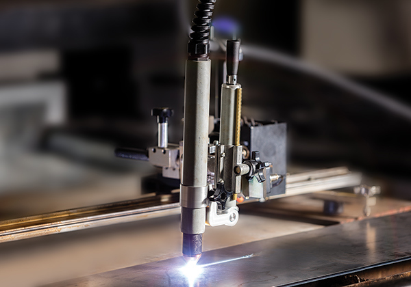

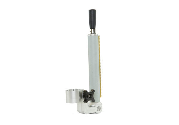

The Hyamp™ torch adapter kit makes the 44 mm (1-3/4″) machine torches (on the Powermax125® and MAXPRO200® systems) compatible with track burners, pipe cutters, cutting tables, and legacy equipment that accept a 35 mm (1-3/8″) barrel torch.
The adapter is also compatible with a wide variety of equipment including track burners from Bug-O, Steelmax, Victor, Koike, older X-Y cutting tables from Plasmacam and Torchmate, and pipe cutting machines from Mathey Dearman, H&M, Sawyer, Koike, Victor, and Wachs.
